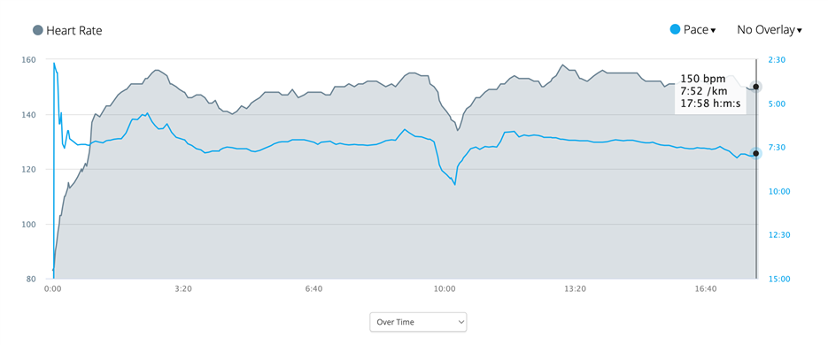

Ever since I updated to 13.22, the HR sensor does not work well at all. Here is my 14 Dec activity. It takes forever to ramp up and doesn't really follow the intensity of the activity anymore:

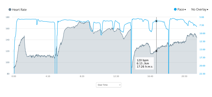

For comparison here is a similar activity from 16 Nov on version 12.27. I know its not an identical workout but I'm just trying to show there is definitely something going on:
I'm also getting more frequent dropouts while cycling on V13.22. It's just not working as good as it used to in the past. My FR935 responds better than this.
