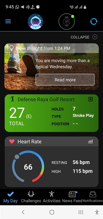

1) Golf activity does not get recorded, only a scorecard syncs to Connect. This messes up health metrics. I am unable to see how far I walked, etc.
Hope Garmin can fix this soon.
