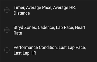

  • I am using the Garmin's native "Run" app and a simple data field "Stryd Zones | Data Field" from the Connect IQ. This data field has been added to the Data Screens. I have not tried the "Stryd Workout App".
