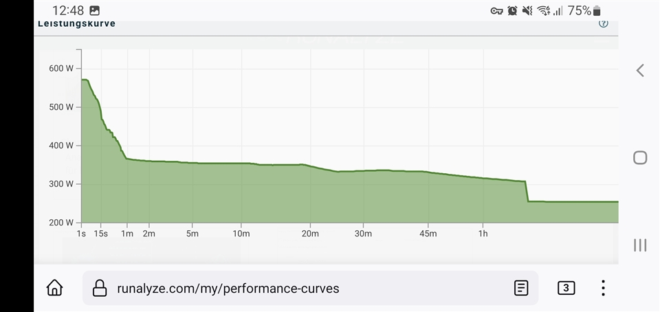

Attached is the power graph vs elevation for the entire run. you can see the gaps where I stopped and approx 4.5km and 5.5km are visible in the power dips. Given the elevation changes and pace changes its not really easy to see if the HRM and Wrist power are identical , but they at least seem in the same range.
