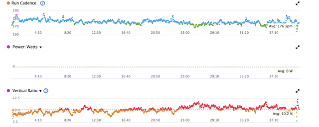

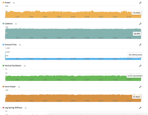

  • This is what I got from my run today after having power set to Disabled and using the Stryd data field
    Native Garmin power is missing, but all the Stryd stats are still there
