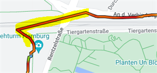

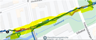

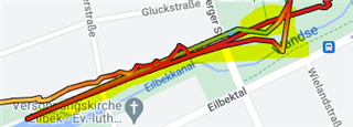

at almost every runactivity massive GPS outliers, this problem was not on my Forerunner 735 with which i ran the same tracks.
This problem appears on my Forerunner 955 solar after update to 12.23.
Here i have some data, hopefully someone has an idea how i can fix this.
Activity on 02.09.2022 at 18:25, Cycling, software 12.23
- Problem at minute 26:06 - 26:35
Activity on 03.09.2022 at 00:11, Cycling, software 12.23
- Problem at minute 5:50 - 6:30
Activity on 03.09.2022 at 11:11, Cycling, software 12.23
- Problem at minute 7:00
Activity on 04.09.2022 at 07.16, Cycling, software 12.23
- Problem at minute 2:00
Activity on 06.09.2022 at 20:29, running, software 12.23
- Problem at minute 5:50 - 8:10
Same on 09.09.2022 at 19:22, running, software 12.23
So it goes on like this at amost every activity there are GPS-outliers which are not only near a Street but far away.
This leads to totaly wrong pace, and maybe to wrong conclusions in other metrics. On cycling i also have the same problem.
