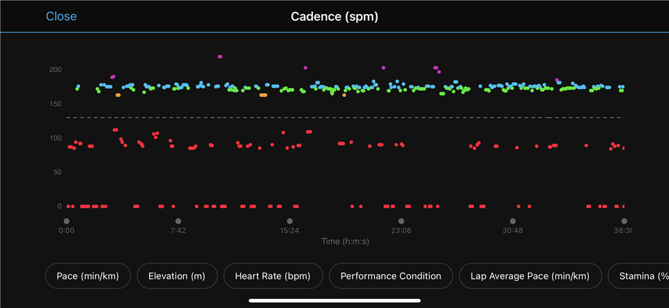

I just bought a new GARMIN 955 solar but this device showed bad cadence pattern
Check out latest 12.27 beta , it is focussed on addressing this.

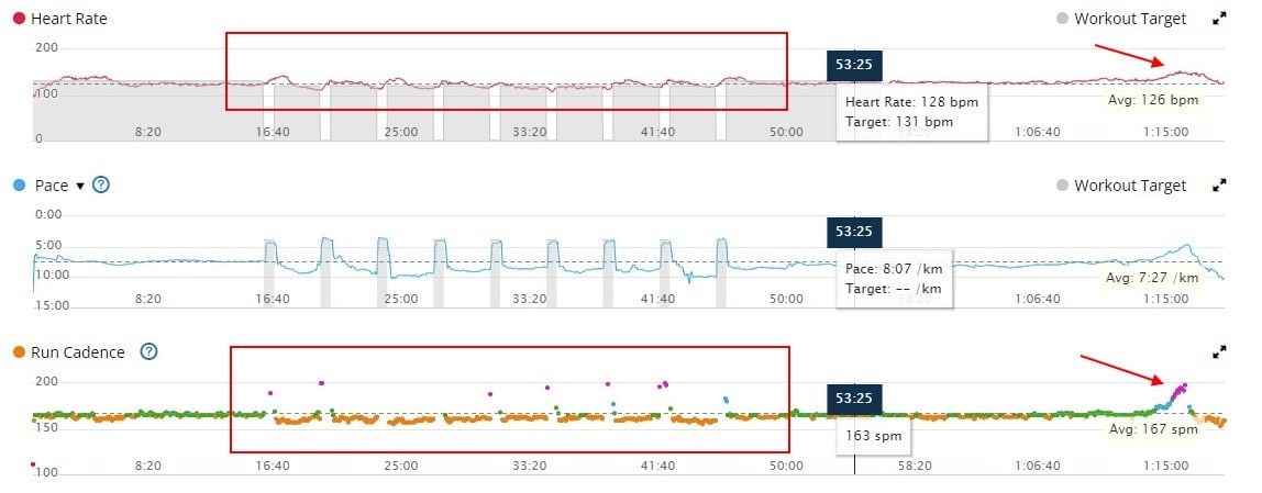

Look at this another problem with cadence.
Interval training.12.27 firmware.
Cadence stops registering if you suddenly start moving fast. But now the pulse also stops being registered!
Does this mean that pulse measurements are not taken from the sensors, but are only calculated depending on the cadence? I can assume that the Garmin uses such a small trick when the cadence is very high and it is difficult for him to measure the heart rate. But this leads to doubt whether the heart rate readings are reliable during the entire workout on the watch.
For the test, at the end of the workout, I accelerated not so sharply - and the cadence and pulse were shown accordingly.
