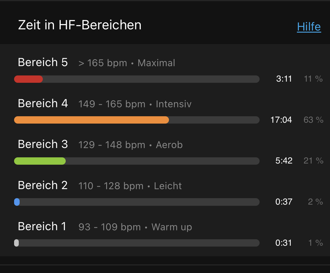

    I created HR Zones that would fit better to my fitness condition...
    The Forerunner 255 outputs the values i have set over the zones using the new update...(my max heartrate is 179 bpm):
    instead of 50% it's nearly 52% but I can live with that
    The Forerunner 955 created following values:
    instead of the setting of 50% it uses 64% and that is to much for sure...(seems ist uses %HRmax calculated by Garmin)
