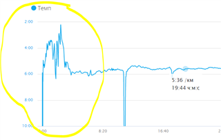

  • GPS not working correctly at the beginning of the race.
    Updated to version 12.2. This morning I did a running workout. At the beginning of the race, the clock showed a completely unrealistic pace - under 2:30. I ran at a pace of 5:40. Then after 4 minutes everything was back to normal. Unfortunately, I wouldn't pay attention to it, but the pace and pulse watch builds the Trining Effect. It showed incorrect data - VO2max training, although it was a Base training. In the settings there was always a multi-range GPS.

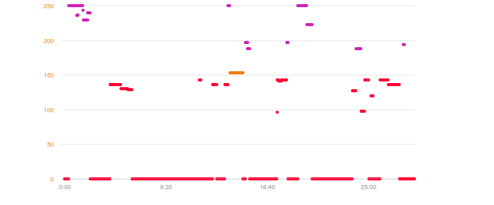

  • Cadence is broken in 12.20, at least for me. I did a 5km parkrun this morning and the cadence was recorded as varying erratically from 0 to 250spm. My usual cadence varies around 170spm plus or minus 10.
  • Works for me<tm> with HRM-Tri. https://connect.garmin.com/modern/activity/9436169161
    Did you use HRM? Or watch itself? Have you pressed power button for 15s continuously after the upgrade? (It usually fixes some weird problems after SW update).
  • I have a simple chest strap HRM which I've used for 18 months both with this watch and my previous one. It's not by Garmin and only does heart rate.
    I have just done a full reboot (15 seconds press on the Light button) and will see how well it records tomorrow's run.
