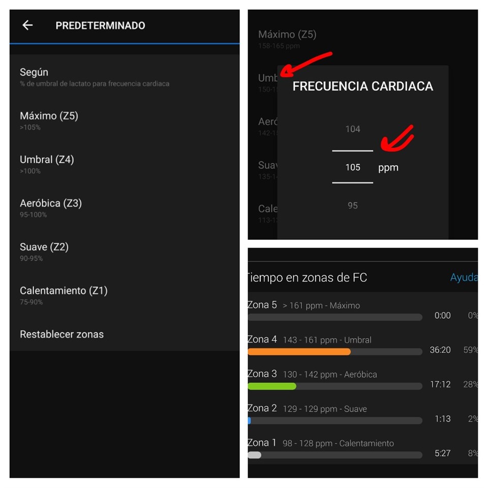

  • In this image we see a double error.
    1. Heart rate set according to my lactate threshold (150 bpm).
    After the race the heart rate zones are random (z2, z3 make no sense. Z4 should start at 100% = 150 bpm).
    Failure 2.
    I want to change my heart rate zones manually again. In zone 4 it starts at 150 bpm, but when I try to change it, the maximum I can add is 105 bpm, and so on with all the other zones.
    I will have to hit reset zones.
    Auto HR is off.
  • I’m also getting this. Seems like a bug
  • I think the 105 you are entering is incorrectly linked to %, not beats per minute.
