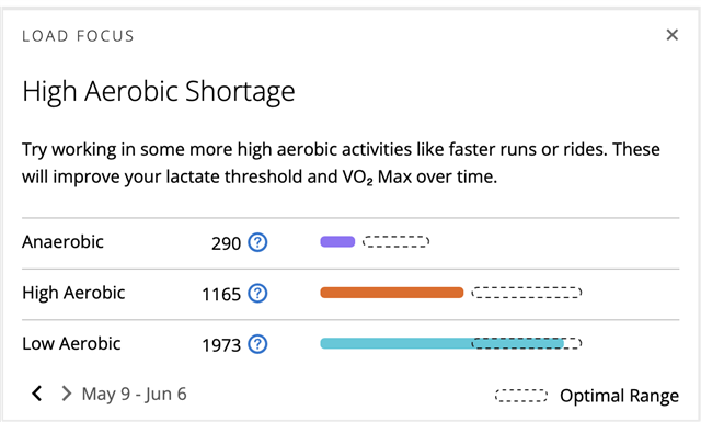

  • The event was an interval workout with several strides, see training load and Anaerobic effort below, my Anaerobic fitness should have gone up a few points, see below images, of before and after Load Focus, not normal to not have a change in Anaerobic nor High Aerobic levels.

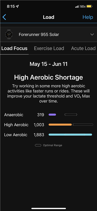

  • Today, after 2 interval workouts that were classified as primary Training Effect: Tempo, with Anaerobic of 2.0 and 1.1, respectively, my Anaerobic and High Aerobic fitness went up as expected.  First reported issue was related to Training Effect benefit labeled as Base or bug, I’ll add here when or if anaerobic or high aerobic fail to update when primary benefit is Base.  See increase in Anaerobic and High Aerobic from today’ workouts:
