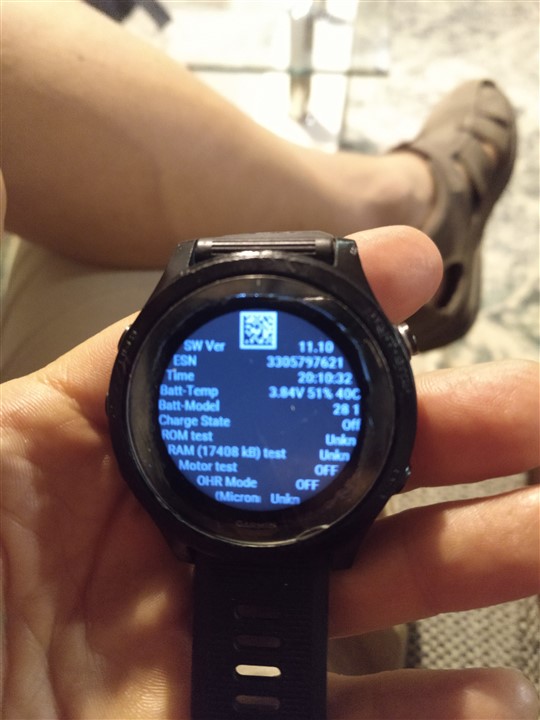

After 1054 days living with my garmin 945 yesterday, it suddenly turned off and after charging it went into debug mode.
after turning it off by pressing 15'', when turning it on it returns to the same text mode.
how can i get out of this mode?

I had a exactly the same issue with my Fenix 3 a couple of years ago. Apparently the lap-button got stuck over the years of (mis)use. When the watch reboots and you hold the lap-button, it boots in debug mode. Looks like you have the same. The best thing to do is contact Garmin support. I ended up with replacing my Fenix 3 with a FR945...
