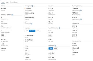

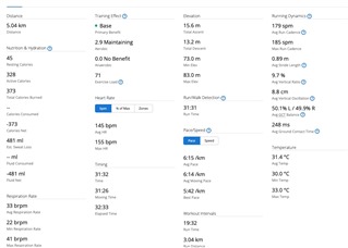

Why would the watch consider a run like this with 79% of max HR as BASE and then today's run which was average 75% of max HR categorized as TEMPO . Even ran at a much slower pace to keep HR at 150 zone. This is truly perplexing.
HOW THE HECK CAN I TRAIN IN ZONE 2!!!! Any help is appreciated. Been super frustrated with this for months.
  • I'm gonna guess it's because the 10k "tempo" run was 1 hour, but the 6k "base" run was 30 minutes. To determine the impact of a run, I think Garmin isn't just looking at the intensity of your runs, but the amount of time spent at a given intensity (and how that intensity varies -- e.g. for intervals).
    It might suggest that your longer runs need to be even slower, so you can build endurance. Or maybe you need to run more weekly mileage.
    As a counter-example, if you ran for 1 km at the same average HR as the 6k run, you'd probably get "no benefit" for your training effect..
    I agree that sometimes training effect seems counter-intuitive. Like when I do slower runs of 20-34 km, they're often labelled as "tempo" even though I wouldn't call them tempo runs at all, based on my speed and perceived effort.

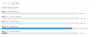

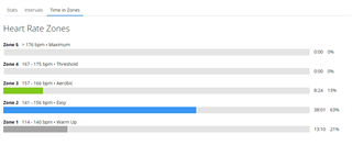

  • Your HR zones look a bit odd. Especially zone 3. It is 164-165 or 168-169. That makes your zone 3 practically non existent. Why did your zones change between the screenshots?
    Your zone 2 also goes really high. What is your max heart rate?
  • Exactly. Not very realistic. and the Max hf is rahter high i suppose,
  • Did you ever do a max. heart rate test ?
    and did you use the calulation of the zones by garmin ?
    And do you wear a Strap ?
    And what did you chose. Scales based max Hf rate or lactate ?

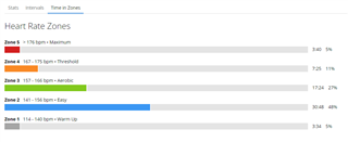

  • Thanks for the replies guys, appreciate any help really.
    My max is 197 bpm , resting is 44bpm
    I use HRM pro
    I have now switched to % of Reserve method. Hopefully the zones are better suited.
    Alternatively this is % of Lactic threshold method.
    Let me know which one looks more realistic to you guys.
  • Lactate is better.
    But still is your max hf realistic. You must be pretty young thow.
    The % of zones is ok now
  • Through various past runs I've gotten the HRM pro strap to auto detect my Lactate at 180bpm but I feel I need to get some really good recovery (2 days or so) and do a proper Lactate threshold test in order to find the actual value. Until then I think I'll try the HR % reserve for now.
    I'm not that young ! 35.
  • I think I'm getting somewhere guys!!
    Never ran so slow in my life but ended up doing a quck 5k recovery today. I the pace was pretty much the culprit along with using the wrong HR zone method. HR % reserve method seems to be working. Today I ran at 6:15 pace avg and I could nose breathe throughout the entire 5k.
    Results :
