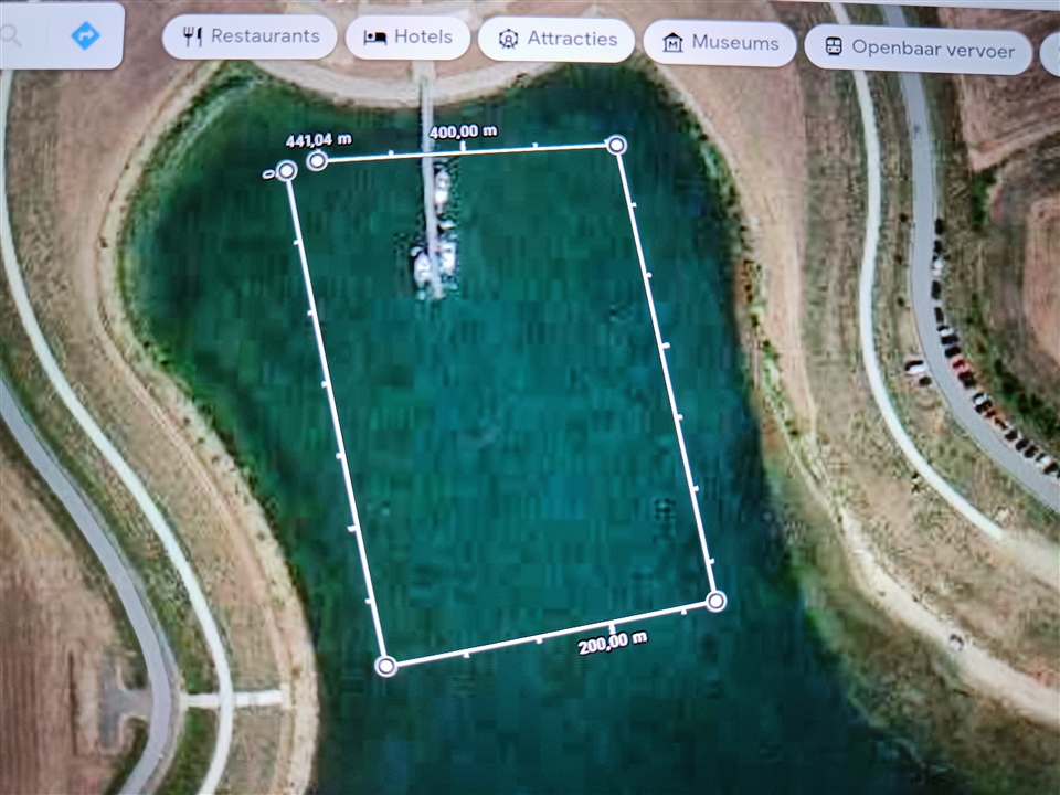

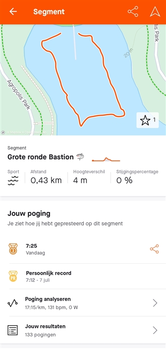

    Okay I did my first open water swim today with my new Forerunner 955 Solar. And I must say when I checked the map everything looks very promosing. Until I checked the distance Face palm tone1my Forerunner with new and so good gps only had 3843m of swimming. While my 2 year old Polar Grit X had 4420m. So I checkt the distance of the Strava segment we have in our swim spot. And this says 430m but it isn't s closed loop so let's say 440m when it's closed. I did 10 loops today. So normaly 4400m exact what my Polar says.
    So why is the oh so good Garmin multiband + all systems over rated gps 600m off? Can someone maybe explain why this can be and if this can be solved? Because a 650euro 2022 watch can't do what my 2020 399euro watch does Ok hand tone1Joy
    I also checked the distance with Google maps just to check.
