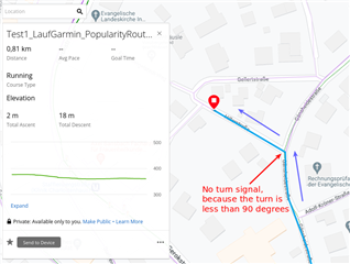

Can I force the Forerunner 945 LTE to generate a turn signal at certain points when navigating by following a pre-planned route?
When I pre-plan a route and then follow it in navigation mode during a running or walking or hiking activity, the problem is that my Forerunner is not giving any "turn signals" unless the turn is really sharp, like 90° left/right or so.
So e.g. if I arrive at a Y-shape cross-sections and the pre-planned route turns e.g. 45° to the right into a side-road (instead of following the main road straight ahead), I won't get any turn signal and will miss the turn.
I am wondering: When creating the route, is there a possibility to label or tag certain way points with a property that telles the Garmin watch "here you have to give a turn signal, even if the turn is not very sharp".

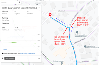

  • Back to my original problem: I now found a way (workaround) to ensure that turn signals will be given at critical locations on my course when navigating along a pre-planned course in the "Follow Course" ("German: "Strecke folgen") setting within the Routing settings of an activity.
    Side note: I strongly prefer the "Follow Course" ("German: "Strecke folgen") setting over "Use Map" ("Karte verwenden") setting due to severe bugs in the latter mode (compare (M4) to (M8) in this German post), like: Not warning when leaving course, not re-locking on the planned course when back on this course, random nonsense navigation orders instead of following the pre-planned course.
    The workaround goes like this:
    When I plan a course in Garmin Connect in the web browser (or in the Garmin Connect app), I am "fine-tuning" the critical turns that are less than 90° but where I want to ensure a turn signal, by using the "Freehand" mode and designing the course, on "micro-level" so to say, such that a >90° turn is included at this location.
    I achieve this by including >90° "micro-turns" that will cause the watch to generate a turn signal. I have tested this and it works as expected - see the following rather self-explanatory screenshots from Garmin Connect in web browser for illustration:
    (needless to say that this increases planning time by factors and is hence a rather cumbersome workaround...)
