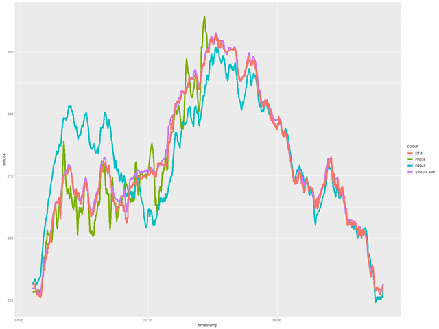

Today I wanted to see how it is actually behaving, so I ran with my FR945, my old FR235, and my iPhone 13 mini, and then compared this with the high-resolution digital elevation model from Norwegian Mapping Authorities.
Here you can see the result plotted, and how the FR945 starts out fine, but then shoots up to over 300 meters, where the DTM rounds off at around 280 meters. It continues to have wrong readings for some time, before dropping a lot under. Halfway into the run it recovered and followed quite closely.
The final elevation gain from the FR945 was 294 meters, and the DTM/Strava was 203 meters. I have reset, cleaned the sensor holes on the back, updated firmware, etc.
