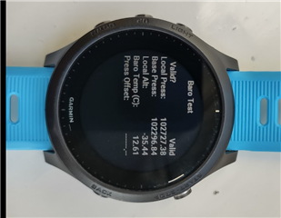

    1. Power off watch.
    2. Hold the Down button.
    3. Press and release power button (while still holding the Down key) to put in test mode.
    4. The Down key can be released when the first page of Test Mode appears.
    5. Press the Back button 8 times.
    The Baro Test screen will show with values (see picture below). Pressure is displayed in pascals, elevation is in meters and temperature is in Celsius.
    This was inside @20DegC. Outside it was just above freezing, and watch showed 10.75DegC
