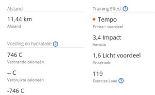

update to 8.2 increased Exercise Load significant
here is a screenshot of 2 exactly identical interval training sessions only differnce is before and after the update(6-nov vs 6-jan).
it looks like these new calculated values are way to high.
also my VO2max value declined from 61 to 55.
in oktober i ran a marathon with a exercise load of 346, my speed is not changed when it is compared to my heartrate.
gave it some time(more than 3 weeks) to readjust to the new/changed algorithm but think there is something wrong.
what can i do to get this fixed?
