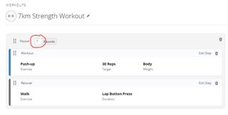

Need Workout assistance: Walk 1km then do 30 Push-up. Repeat until activity is completed.
I would like to record a Workout where I would have to do 30 Push-up at the end of every 1km (lap) walking distance.
Example: if I walk 5 km, I would have to do 30 Push-up at the end of each km (so in total 5 x 30reps).
Any suggestions?

    or alternately just record a walk with watch with autolap at 1km or a programmed workout with 1km walk, then pushups (other) until lap press, 1km walk...repeat.   Then manually enter a strength workout with ## pushups for total time of the pushup laps.  Could also pause watch during pushups to prevent accumulating 'walking time' while pushups (since you will enter pushups in training log manually).

    I tried teh Multisport but then the load is not correctly allocated.
    Will try the workout suggestion as per below image:
