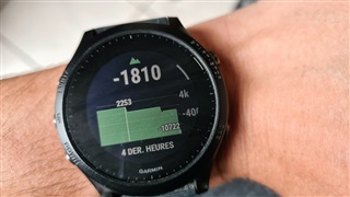

  • A picture I took at 8am, during the night (5am ?) the watch decided to go from 79meters to 2225meters.

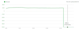

    Here's an update : 1h30 ago, before my training I manually calibrated the watch (to put it back at 90m) and went training for 45 minutes.
    During the training, the watch recalibrated and went to -1000 and after -10000+...
    Some points :
    • again, the watch decided to go cuckoo (-1000m and even -10000m ?!) (see image)
    • for the training, the altitude used is not from the GPS altitude but from the faulty altimeter (see image)
    •  bonus question : I calibrated the watch 1h30 before the picture. How come the graph is supposed to display the last 4hours, but in fact it seems it displays only the last 2 hours ?

  • Usually, I wouldn't care for this information. The only thing is that it impacts the trainings. Every time you train and there's a glitch, you have an elevation report totally wrong, not to mention a huge impact when you have "3D speed" enabled : then you'll have a pace of 0 seconds per km (because the watch thinks you climbed 5000 meters in 1 second !)
