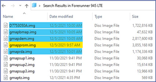

    I connected the watch to Garmin Express and reinstalled "TopoActive Americas North 2021.20." The 3 other options were "coverage" maps. After that completed, I checked the watch for changes to the .img files and noted one updated img file and four new img files. including the previously non-existent gmapdem.img file.
    Then I did a calibration using DEM and success! Thanks for your help.Slight smile
