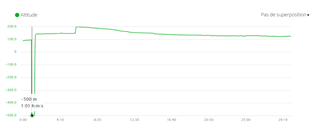

    I'm currently at 90meters, everytme I start a training (or even during the day) the altimeter goes sometimes at -4100m for some minutes.
    I tried to fully wipe the watch (twice), auto calibrate dozens of times (I even wrote to forerunner-beta mail with details).
    I'd be more than happy to continue the sharing with you because I love my watch but I don't like this bug Disappointed
    You'll see an example on the weird behaviour hereafter.
    Looking forward for the next steps.
