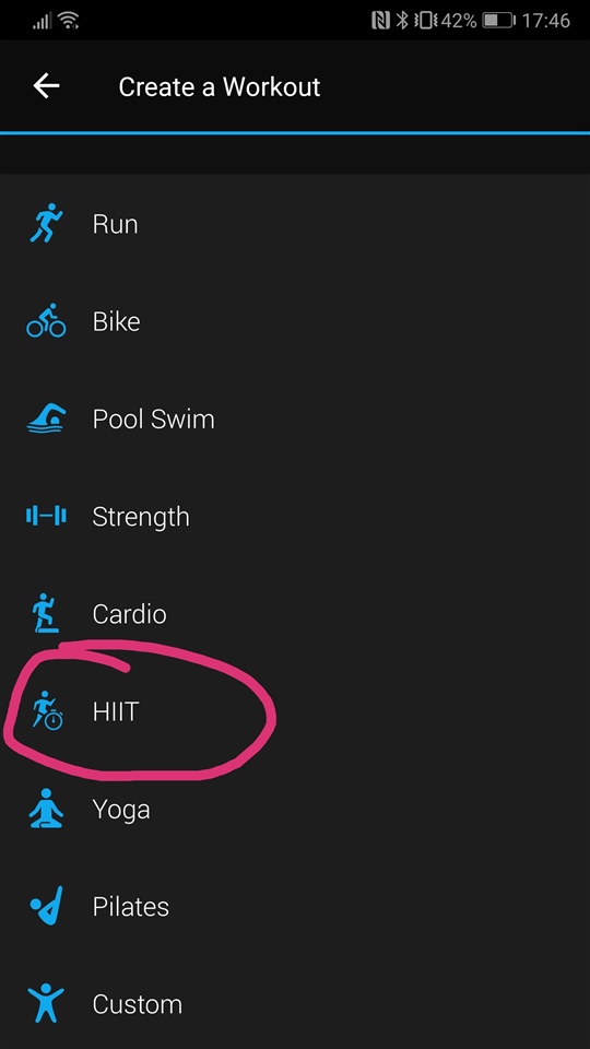

I created a HIIT workout and could send it to my 945 and sync. I then selected the HIIT activity type in the watch, selected Workouts and could select my workout.
Could you describe your issue in more detail? Maybe a step by step with exactly what you do and what you see?
Did you really create a HIIT workout?
When I create strength, cardio or custom workouts and add them to the calendar I can see them in the training calendar for HIIT but they will not show under workouts. Only HIIT workouts will show in the workouts list.
It is easy to check the activity type in the workouts page on the web: https://connect.garmin.com/modern/workouts
For the app you need to check the icon. It must be the one with the stop watch.
Have you sent the workout to the watch? You need to Send to Device if you wish the workout to be "permanently" stored on the watch, making it possible to start it from the watch regardless of whether you have added it to your calendar or not.
If you only add your workout to your calendar and sync, I believe that the workout will be there only during the day of the planned workout and then it disappears again.
