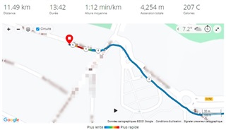

Hi,
I'm really happy with my 945, but recently, it started considering I'm the fastest person alive.
Let me explain : I start a training, let the GPS fix, wait 30 seconds more (we never know) and after 5 to 10 minutes, the watch starts indicating a new kilometer almost every second.
The behaviour is happening quite often recently and as you can see in the screenshot, the GPS is quite accurate and we can see the correct third km, but then the 4th, 5th and 6th.
Of course, i can correct the training afterwards on the website, but I don't understand why this glitch is there.
I'm on 8.09, with GPS+Galileo (actually GPS+Glonass doesn't improve) and autolap (1Km).
Am I the only one to have this issue ?
Thanks !
