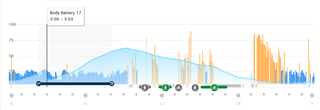

Yesterday I was contemplating how the body battery algorithm would cope with daylight saving, and behold I guess I have stumbled on a glitch Slight smile
Looking at the graph the BB level reverts back to the level it had 1 hour prior, when at 3AM CET the clock was put back one hour.
Not a real issue, but the additional hour sleep did not add to restoring my BB so my Garmin suggested to take it easy today.
(btw: sleep tracker, missed the additional hour too)
  • For me the graph is all smooth with no gaps or jumps. Yesterday the time was 1 hour wrong on the x axis but when I check today the time is correct. I can't see when the time was adjusted.
  • I understand your yesterdays graph was changed today, what made me recheck my yesterdays graph.
    At my side, it still shows the drop in BB level to the level it had 1 hour prior to the daylight saving time adjustment. (We had 1 hour of additional sleep that was not counted).
    Below showing now complete graph, including stress.
    (My 945 SW version is 7.8)
