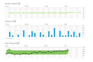

  • Hi NickMN and thanks for your reply.
    Some of the Training Effect and other workout details are below.
    Vo2Max is at 49 and I have customised the HR zones as the automatic ones weren't matching well with perceived effort. I haven't changed the HR zones for 6 months or so as until recently the Garmin results "felt right" with my perceived level of effort.
    The instance below isn't the only time I have seen a tempo result from something that I thought was much lower.
    I've tried to post the workout: Garmin Connect
