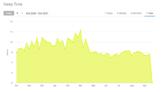

  • I checked my sleep data for 6 months back and I don't see any changes.
    Have you checked the movement for your sleep? Since you says it misses the start of you sleep then check the movement just before the watch logs sleep. Use the web and click the movement button: https://connect.garmin.com/modern/sleep/2021-10-08
