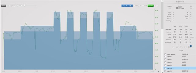

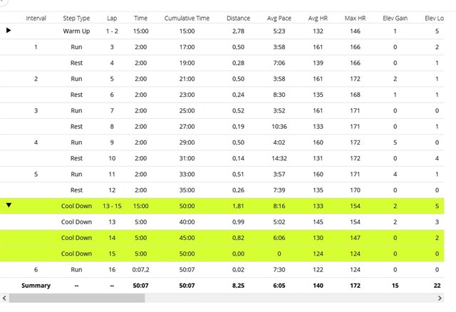

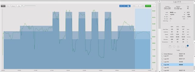

    This is data for last lap of interval.
    And the data for added lap with zero data, but it ads 5min to total time and time for intervals 13-15 as shown in GC with zero distance and zero pace and random HR. And that is why all the data except distance is wrong.
