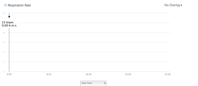

my Garmin 945 captures and reports respiration rate when I run inside using the Treadmill Run activity. but when I run outside using the Run activity, there is no respiration rate. does anyone know how to setup the watch to capture respiration during the Run activity?

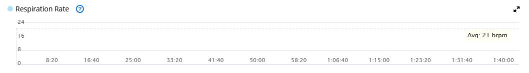

    obtaining Respiration Rate data from both a non-Garmin external HRM (not listed there) as well as the onboard OHR.
    I think you're focusing to much on the listed straps.  Garmin is listing their products as a "for example".  If it works with a Polar strap, it's kind of senseless to list (advertising for the competition) on their own website.  Anyway, the point was others (and Garmin) are saying they only get a respiration rate during an activity while wearing a strap and you're saying it's working during an activity with the OHRM for you. Is this correct?
  • I get no respiration rate when I run outside. I only get it when I run on the treadmill.  the only difference I can think of is that I run inside with a chest strap. I think the brand of strap is irrelevant . there is a different problem. almost like the Run activity needs to be configured to capture respiration and the Treadmill Run is already configured to do that. I guess I'll try a treadmill run without the strap and see what happens
  • Former Member
    0 Former Member over 4 years ago in reply to 2552364
    This is exactly what I'm saying.  I believe the strap type is irrelevant also and I only get a respiration rate running outdoors with a strap. I never got one just using the oHRM.  I'm not sure how it's working for badbri but not us.
  • I stopped commenting because subsequent replies were derailing the original poster's thread, and also because 99.9% of my activities involve an external HRM.  But yes, the one time I ran without my HRM this past weekend there was a Respiration Rate graph included in the activity file so something buggy must be up with my and the original poster's devices.
    P.S.  Indoors vs outdoors is irrelevant as I get Respiration Rate data in both.

  • I have software version 6.2. Autoupdate is On. should I be using a letter version? if so, how do I force an update if autoupdate has me on version 6.20?
  • There is no need. If you are running indoors with a strap then you can expect to record respiration rate. If you run outdoors using WHR (or indeed any other ‘active’ activity) then you won’t see respiration rate recorded. That is as expected. Respiration rate is only recorded from the WHR during low intensity activities such as yoga, breath work etc, or when resting.
