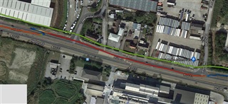

The first run today I ran the usual route and the 935 instant pace was good whilst the 945 was jumping from 5:00/km to 5:25 and even 5:40/km in the same usual spots it always does. It was strange to see the 935 hold 5:05 as I passed the same 200m stretch the 945 always goes haywire. It's good in open roads but not with trees on either side and not around certain buildings. The map of the 945 tracks was terrible (check out the start of the run around the houses it's WAY out, worst I've seen it's usually not this bad so I'll see what happens in the following days. The laps and overall pace are mostly equal as it is with my FR10. Used GPS only for both watches as GPS only works better on 945.

Such a shame because I can see all the little improvements made to the 945 now, so many little things that all add up that I will miss, they really refined it for example lap history on a saved activity seeing all laps same screen with heart rate too, the options dialog when starting an activity, the sunrise/set widget having 24 hour numbers and sunlight left, screen is less reflective I can see my face in the 935, the heart rate gauge field, having weekly distance on the watch. But he most important thing is GPS, the GPS is already not great so it's important to have the better one. 945 GPS is flakey for instant pace and I'll like to test it on a shorter workout intervals to see how it performs.

  • I don't agree. It CAN be as good yes but it's not consistently as good, it has bad days like today for example and it happens too often. The 935 is more consistently accurate I can trust it to use it as a training aid as I could my FR10. The Sony GPS is inferior the 935 can even get a signal in my house downstairs whilst the 945 only upstairs and it takes longer. I know it's been debated but this is my personal anecdote. Whilst using the 935 and FR10 the instant pace stays stable whilst the 945 struggles in tougher environments and reports 10-30 seconds per K slower but somehow the laps are the same so I guess it knows it messes up then recalculates you can see that in the pace graph as a big spike drop followed by a big spike increase showing it recalculates the time/position. That's fine for 1km laps but not for instant pace or shorter intervals.
