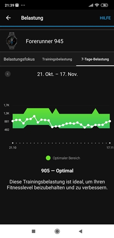

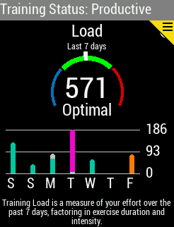

I have a Forerunner 945 on fw 5.50 and an edge 830 on beta few 6.25. I have physio true up enabled for both devices in the gc app but the 7day load data and recovery times remain different.
I use the 830 whilst doing zwift workouts and the fr945 for running 3 times a week. This morning I did an hr long zwift workout and made sure i synced the 830 using the gc app. Post workout the 830 told me to rest around 30 hrs. I then synced the fr 945. The load focus and 7 day load data on the gc app is still showing slightly different...the fr 945 is showing 0 hrs rest needed whereas the 830 told me to rest about 30 hrs after the zwift workout this morning.
Physio true up has worked previously between the two devices but currently the situation is quite frustrating. Anyone else seeing this?
