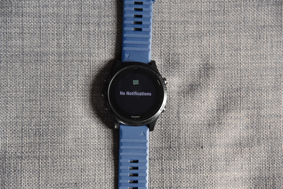

  • Hi,
    Thanks for your answer,
    Here is what the widget looks like.
    I am using an Android 6.0.1 Galaxy S5 (SM-G900F) phone
    I do receive phone calls correctly on the watch
    On the phone BT settings I do not see my watch, it is paired from GCM (I tried to remove the watch from the app but I could not pair it directly via BT: no interface to enter the security code).
    Nevertheless, both in GCM and on the watch the BT connection looks fine with a green dot
    All activities are synchronized correctly.
    I upgraded yesterday my watch to 5.32 beta software but this had no effect on the problem.
