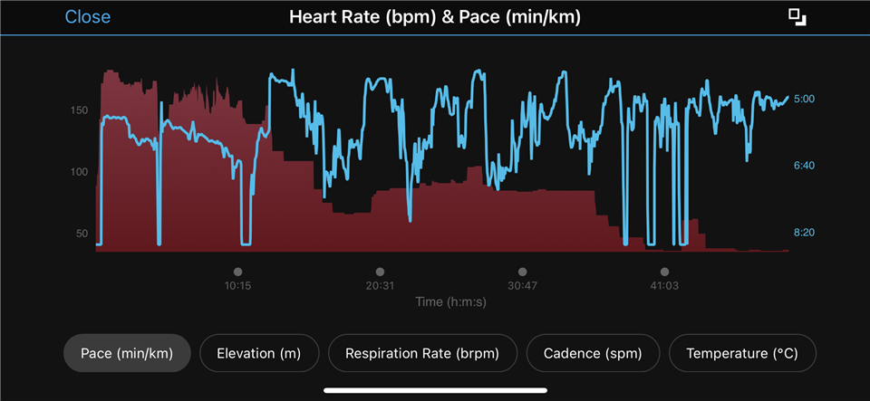

I notice when I start a run the hrm is often up at about 170, but this I am certain is totally wrong. It is like it even if I’m doing 11 minute miles for example.
It stays like that unless I walk, then it comes right down and I can run again and get reasonable results.
However, on my second session today it was mad. Went to 185 whilst doing an easy warm up - I then did a very tough fartlek session and the hrm continually dropped as you can see in the pic and afterwards I had an average hrm of 94. Totally messed up the data for me - about 280 calories when for 5.50 miles it would more likely be 700 even for an easy paced session, and the training effect was probably effected. The hrm has a new battery and the earlier session recorded fine.
