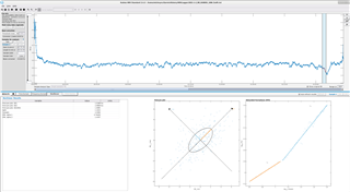

    If you don't mind, the gas exchange is instructive for folks out there and I will comment here.  Using the excess CO2 method, here is the graph (look in the link for more info on how to do this)
    It actually looks like a textbook calculation of the VT1, better than many I've done.  The heart rate is about 150 and the VO2 2.52 L/min.  The power calculation is a bit problematic since it's such a fast rising ramp.  Although it works out to 250 watts, it can be way lower due to something called the mean response time.  I'm surprised they did such a rapid ramp on you.  Typically it would be 10 watts per minute, not 25w/min.  The VO2 max should be valid.
    Now on to the HRV.  Here things are not good.  Although your ramp is well done, the artifacts are quite high.  I did not do any detailed analysis (garbage in - garbage out).  Here is the Kubios "time varying" plot.  The artifacts listed are not accurate in auto correction mode. Here they are in threshold:
    DFA a1 in black, avg HR in blue.
    Note the initial green arrow down then up for the DFA a1, that should not happen although occasionally it does (see below).  After that it does drop again, but the artifacts are too high to get an accurate picture.  However, clearly at the end of the test you were low in the .5 range (red circle).
    Here is an example of something I'm working on now, a patient with heart failure, as the heart rate rises, the DFA a1 declines and we figure  a corresponding HR value by using an equation.  There is a slight plateau in there but overall the linearity is good.
    Bottom line - just repeat your ramp and we will take a look.  Gas exchange looks solid but is a short test and the VT1 cycling power is "artificially" high.
  • This was very insightful, thank you! I will re-do the test and use conductive gel next time to minimize the artifacts. HR strap is H10. Power at VT1 seems quite high as my FTP is around 280W at 165 bpm. On the other hand, I was aiming for several seasons to improve my aerobic base and get VT1 in VT2-10% area. So from this standpoint, it could be indeed near 250W. If I compare it with my interval sessions, cycling in sweetspot around 250-260W does result in HR around 150 bpm.
  • The H10 is a solid unit but it suffers from artifact in some people.  Your power at VT1 is not the power corresponding to that time of the test.  As I mentioned, the MRT shifts the curve depending on ramp rate of increase.  At the rate you did it could be 20 watts or so.  Juan Murias and his group have published extensively on this if you are interested (see the link above).  Even if your VT1 is 230 watts, that's still excellent.  FTP is a good index as well but is also protocol dependent.
    Besides doing a ramp to determine your HRV threshold, just looking at your training session can be helpful.  Take a look at Figure 3 in our Frontiers article.  This method is great for enforcing polarized training.  Unfortunately, you would need to upgrade to Kubios premium to do that.
