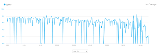

Since updating last week each session I have will include either a single or two instances during my workout where my speed is recorded at a ridiculous level (circa 365,000km/hr.)  Has anyone else had this problem?  I tried deleting and reinstalling the watch to garmin connect but that didn't fix the issue.

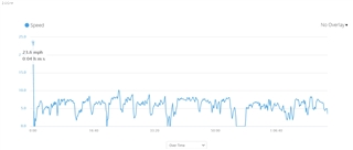

  • Yes - I have massive spikes in my Kayak activities - 11,000mph is the latest one. I have a 945 installed on the deck with a clear view of the sky and on most Kayak session I see between 1 and 4 massive spikes.

    That’s interesting as mine is also set to the Kayak activities. I might try a different activity setting to see if that makes a difference.
  • I've had quite a few spikes in SUP activities as well, over the last couple of months. (These are actually outrigger canoeing activities, but recorded as SUP on the watch). GPS seems fine in all cases, so its a bit mysterious where the speed/pace spike comes from. Its very annoying as it makes the distance per stroke and speed graph unusable.

    I use mine for surfski paddling (but I use the Kayak activity as the closest description).  My annoyance is the same as yours as it renders any meaningful review of the speed graphs worthless.  I thought it may have been the Kayak setting but if its happening to you on the SUP setting then perhaps the setting isn't the issue.
  • I think you could be right - I don't get the same issue with running or cycling, only with the Kayak activity.

  •    Over 10,000 MPH in my Kayak!
