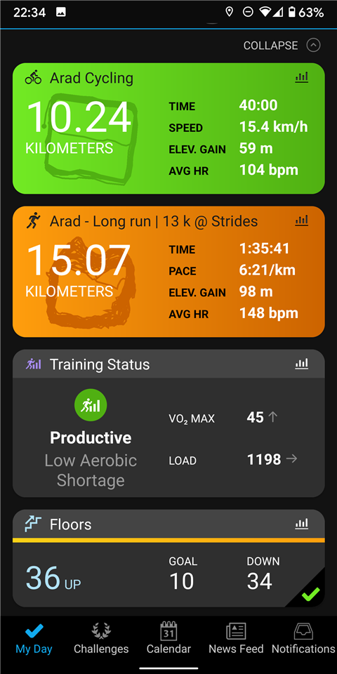

    3 weeks ago about. I am on 4.40. Today I run 15 km and when I checked GC I seen at Climbing card 34 up 32 down! In reality is only 1 up and 1 down...

    Running and Cycling did on same route 108 m Today.

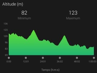

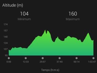

  • Hello, I agree with you.
    For me, it's due to the GPS accuracy.
    Setting : GPS+GLONASS
    Covid19 restriction in France : I have to run in the city (so, buildings and trees)
    Accuracy of GPS : 20-30 meters in this context (it's important to take into account that)
    My start/end point is 106 meters from Google Earth data.
    Look at this 2 exemples in Run mode (I can provide more...)
    Ex 1 : The start point is too high. Because there is my building at 20 meters and I think GPS take a point on the top of the building ^^
    The watch was adjusted the elevation during the run.
    At the end, elevation is too low, it should be about 106 meters.
    Start or End, I retrieve the magic numbers GPS error : 20-30 meters
    Ex 2 : The start point is perfect !
    But the end is too high : +20/30 meters
    One more time, I retrieve the magic numbers GPS error : 20-30 meters
