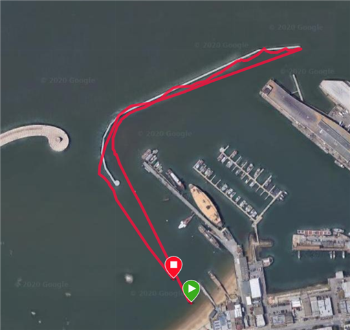

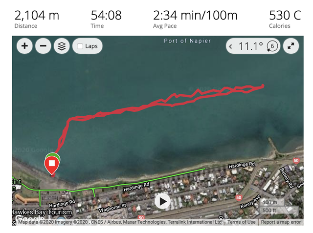

  • Nothing special from my side other than what I wrote. This is from a particularly 'nasty' swim with some very rough water - just over 2min/100 from left to right then closer to 3:30/100 coming back from right to left. I'm would not class myself as a good swimmer. I have a stroke rate of around 30/min and can hit 2min/100m on a good day in the pool.

    The reality is that there can be good days and bad days with GPS tracking; fortunately I have mostly good days with the occasional bad day. And this has been consistent since the 945 was released. Take a look back to the early posts in the 945 forum about open water swimming. Initially it was pretty poor but then got better after updates then occasionally poor before another update 'fixed it'. The main factor impacting swim recording is undoubtedly swim technique. Freestyle is the best stroke but you do need to have a reasonable technique. I'm a reasonable swimmer but I do have a low stroke rate of around 30/minute and a moving pace around 2:10/100m on a good day.
    Satellites too move around so if you happen to have a day when they are close to the horizon you are likely to get a different result than if they all happen to be closer overhead. But that's true of all GPS activities.
    My settings have remained consistent throughout all my swimming - 1s recording, GPS+GLONASS, PhysioTrueUp on.
    Simply put, there are many variables that affect the output for open water swimming. If you are continually having problems then contact Garmin Support as you might have a defective watch. If it keeps happening then the problem might well lie closer to home.

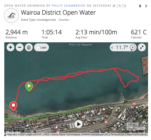

    To illustrate: Swim yesterday with 945. Track suggests that it started recording some 200m offshore (I did start it before I got began swimming) yet distance and time was recorded throughout Overall distance is close to 500m further than it should be - known course of ~2500m,

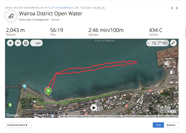

    Today's swim along a measured buoy line of 2000m. No problem although you could argue the track is not too flash it does reflect the overall path taken.

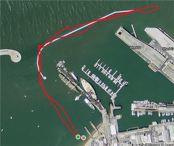

    Just completed a swim, wearing both the FR945 and Apple watch 4.
    Garmin measured 2622 yards:  https://connect.garmin.com/modern/activity/4912317825
    Apple Measured 1852 Yards
    Apple was spot on for distance. Both watches were not quite perfect for the track, but I would not expect the track to be perfect. I swam on the land side of the wall heading towards the right and returned on the seaside of the wall when swimming to the left. It's very clear the Garmin did not capture any of the swim heading to the right along the wall.
    I swam front crawl and floated a bit with the current on the way back.
    Hoping Garmin Tech Support reads this thread!
