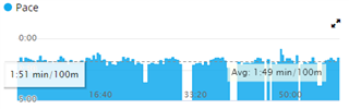

When I looked at the report in connect I saw that there seemed to be 5 rests logged that never happened in my swim.  The distance logged was 2850m instead of 3100m.  Overall, I've noticed that a fair portion of my swims come out a 25 over / under even without "phantom rests" showing up in the log.
