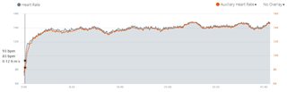

  • From this morning's run... Using the Auxiliary Heart Rate widget (Wahoo heart rate strap) and the FR945. I see zero issues when running.

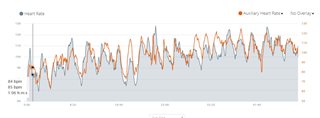

    Now, Strength training, I have to wear the watch a bit further up the arm to reduce issues with gripping weights, and use a sweat band to keep it in place to get good results, but even then, those results do not look perfect.
    This grip issue also happens when I bike. I have to be aware that movements while biking can cause the watch misread HR.
