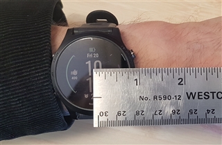

UN-related to battery drain: wear your watch correctly. I see a lot of photos of people wearing them right at their wrist. It's supposed to be about two-inches up your arm, well away from the bony protrusion in your wrist, per this entry in the manual: https://www8.garmin.com/manuals/webhelp/forerunner945/EN-US/GUID-F2E7E0A9-FB44-4297-BF4D-D0C31C400C45.html
Wearing your watch too close to your wrist will screw up HR and HRV readings which in turn bork the metrics for all sorts of things like Stress, and Body Battery which is driven by HRV stress. Further, it may also mess with sleep tracking as the watch measures wrist-actography.

  • Good luck wearing your watch so high on your hand. It's highly uncomfortable and if you're wearing a sleave over it good luck checking the time.
  • No where in the documentation you posted does it state "two inches." It says, "Wear the device above your wrist bone." You're just taking the picture way to literally. Unless you have very skinny forearms, at two inches you won't even be able to latch the strap. I know I can't... I tried.
    Maybe not. The manual does say two fingers lengths above the wrist bones. I have average size fingers and was very surprised when I just measured my length at 1 3/4 inches, so 2 inches isn't unreasonable.
    support.garmin.com/.../
  • I just measured my length at 1 3/4 inches, so 2 inches isn't unreasonable.
    FWIW, I wear my watch with the centre of the OHR sensor about 2 inches from the base of my hand. That coincides with "about two finger widths" from bony protrusion in my wrist.

    0 Former Member over 5 years ago in reply to Otto-Destruct
    I wasn't measuring to the center of the watch where the sensor is, but to the edge of the watch. So, I'm actually slightly over two inches.
