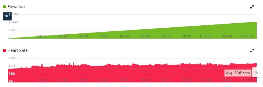

  • So here is my heart from today's run, I've made 3 intervals and the heart rate seams to be quite on spot

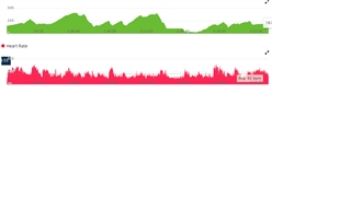

    This is a MTB ride last saturday, on those big climbs I was doing near maximum effort and the heart rate is bellow 100 BPM when it should be above 160
  • Yeah, OHR on bike is crap... that's pretty well known.
    Was talking about a GPS track (connect link) myself, that's what the topic was mainly about right?
  • The OHR has never worked well for me on my roadie or MTB. I think the vibration and impact that you feel in the wrist while riding screws up its accuracy. I always wear a chest HRM connected to my FR945 and Edge 530 when I am riding.

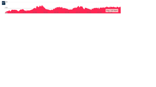

    today I was training on zwift with my indoor bike, my writst had almost no movement and the heart rate measure from my 945 is near to ridiculous.
    I was doing a 50min all out effort and the heart rate was bellow 100bpm for too long
    garmin 945
    This is the same effort with my old 735xt
    735
    Don't come with the usual commentaries, If you want to track heart rate use a heart rate band! On my indoor bike my 735 was quite accurate in recording heart rate and really useful on indoor bike where you get a lot of sweat and destroy a lot of heart rate bands.
