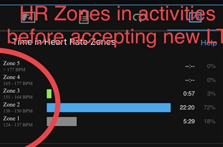

  • Here are a few screen shots to show that Zones are the same in web GC and in GCM. But the watch use different zones base on max HR recorded in the watch. This happened only after I accepted the new LT recently. Previously, accepting new LT did change zones or max HR in the watch.
    There is no special HR zones for different activities (run or bike), all zones are default and common.
