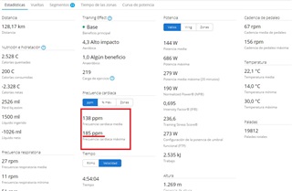

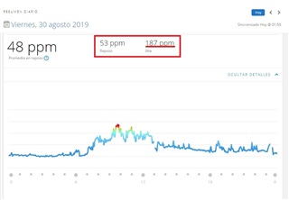

Hi all,
I leave here an image that shows what we have been saying for months (since version 2.70), the daily tracking HR without being active is disaster.
After one run, the clock marks 40 beats less that the HRM-RUN band.
A greeting.

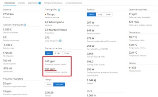

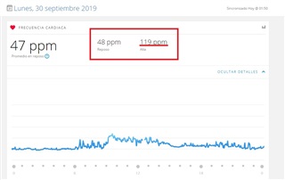

  • Hi,
    Example, the watch is not recording activity, while doing road bike with Edge 830.
    Version 2.70, you can see how the ppm of the day are close to the values ​​recorded in the activity with the 830 and HRM-RUN.

    Version 2.80, it can be seen how the ppm of the day does not approach the values ​​recorded in the activity with the 830 and HRM-RUN.
    https://connect.garmin.com/modern/activity/4110403265
