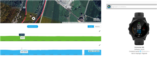

  • In Strava the gps instant pace of FR945 is correct and matches the instant pace of the FR610 that was paired with a footpod. I attach screenshot in the moment that I run beside a little house. Time in Strava (1:06:36) is a bit different than time in the FR945 and in the FR610 (1:06:45), but this doesn't matter, because we have as reference the point beside the house:
    1- gps pace of FR945 that I read  in the watch during the run and reported after in Garminconnect  -> 4:55/km (this is wrong, I was faster)
    2- gps pace of FR945 in Strava -> 4:19/km (this is about correct)
    3- Runscribe footpod pace recorded by the FR610 - > 4:19/km (this is abouot correct)
    Lap pace of gps  was about the same and  correct for all FR610 (4:40/km), FR945 garminconnect (4:43/km), and FR945 strava (4:38/km).
    It seems that in some moments instant pace from gps of the FR945 gets out of whack and reports completely wrong values. This time it was not a matter of seconds, but the watch reported a completely wrong value for 3 minutes, even if the track is perfect and if Strava reports the correct value. Probably there is something in the algorithm that causes some errors. The watch FR945 was connected with a ANT+ Garmin chest strap heart rate monitor and with the CIQ app Gaitcoach (that was receiving data from the Runscribe foot pods).  The ANT+ footpod was set to off in the menu of the watch and was not connected to the FR945. The FR945 was with GPS+Galileo
    I attach screenshots
