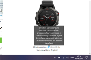

After reading about the problem in this Reddit post, I checked my last runs (out and back) and I compared the obviously wrong data from the barometric altimeter with the "Elev corrections" enabled data.
I'm using GPS height data to show how wrong my barometric altimeter is. First run is off by - 70m under sea level at the end. Second run is off by +100 meters. Despite both runs being out and back courses…

I'm using GPS height data to show how wrong my barometric altimeter is. First run is off by - 70m under sea level at the end. Second run is off by +100 meters. Despite both runs being out and back courses, barometric altimeter data is also not symmetric.
