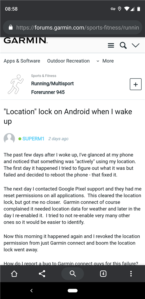

The past few days after I woke up, I've glanced at my phone and noticed that something was "actively" using my location.  The first day it happened I tried to figure out what it was but failed and decided to reboot the phone - that fixed it.
The next day I contacted Google Pixel support and they had me reset permissions on all applications.  This cleared the location lock, but got me no closer.  Garmin connect of course complained it needed location data for weather and later in the day I re-enabled it.  I tried to not re-enable very many other ones so it would be easier to identify.
Now this morning it happened again and I revoked the location permission from just Garmin connect and boom the location lock went away.
How do I report a bug to Garmin connect guys for this failure?
