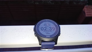

  • Thanks, but not really related to this question/topic right? If I see this correctly you just put your watch down in ultratac mode with a running activity and let it deplete?
    Interesting battery wise, but not really answering the question here ;)
