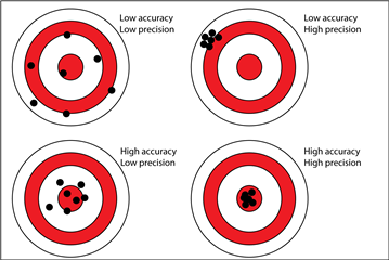

  • The 245 doesn’t have a barometer sensor built in, so the elevation from GPS is ‘noisy’ as the maths behind GNSS vertical position location means it’s precision is approx 5 times less than horizontal (some basic info from Garmin here https://support.garmin.com/en-GB/?faq=QPc5x3ZFUv1QyoxITW2vZ6 ). Elevation from a barometer is very precise (can show very small relative changes) but can be inaccurate if not regularly calibrated (accuracy being the right relative position); this is due to changes in barometric pressure from weather, temperature and other localised effects.  Happily the 945 (vs 935) can now continuously calibrate its barometric elevation using the Digital Elevation Mapping loaded on to the watch; so you should get the best of both worlds (precision and accuracy).
    I can’t find any Garmin support pages for the 945 about elevation continuous calibration, but that doesn’t surprise me as it’s a fitness division watch rather than outdoor division. Anyway, as the MARQ is the same as the 945 in fancy clothes, the following support page is relevant https://support.garmin.com/en-GB/?faq=Gl2juBbnSc1NJ36gkA9hS8&productID=633625&searchQuery=Elevation%20continuous%20calibration&tab=topics#related
    Best description of precision vs accuracy is the chart below. GPS elevation is accurate but imprecise (bottom left) and barometric elevation should be accurate and precise if calibrated (bottom right).
