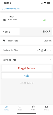

  • Doing it again this morning, then I noticed a message flashed up that it had connected to a Tickr Chest Strap that is hanging in my bathroom!! Turning that connection off appears to have fixed the issue.
    Now to try and work out why the Tickr was "on" and broadcasting an HR!
  • Was your TICKR sensor connected to the strap and if yes, with both contacts?
