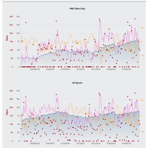

    I'm a 44yo masters Cat 1 mountain biker.  The big uptick was a race.  I was absolutely pinned for the race (state champs), 2h race and 1h warmup, and really put in a max effort.  That explains the big spike.  Since, I've settled into a more "routine" regimen, following a trainer road mid volume plan mixed in with fun MTB rides and a travel MTB and road bike vacation last week.
    My peak CTL this year was 90 (I'll attach TP graphs below), so that gives everyone a comparative metric for my base which really wasn't all that astronomical in the grand scheme of things.  Don't get me wrong, it was a big ATL load, a top 3 on the chart.  Subjectively I do feel recovered from that effort and I'm feeling pressured to train harder for my "A" race (nationals) in 50 days.
    One followup question for   because the response was so helpful, does wearing the forerunner 24/7 influence the overall recovery score in any way.  In other words, does the FirstBeat algorithm take into account the information outside workouts such as resting heart rate, sleep, etc that would be collected?  I abandoned wearing the watch for my Apple watch because I have super skinny wrists and a very low RHR (40).  I found the optical sensor was not accurate, often reading double my RHR.  Not always, but enough I considered the data unreliable.
    For me, the take home message is pay attention only to the 7 day graph (lower right in image above) and (almost) ignore the other graphs.  If I stay in the green for a while the others will catch up.
    Thank you again everyone for the thoughtful replies!
    PMC Graph
